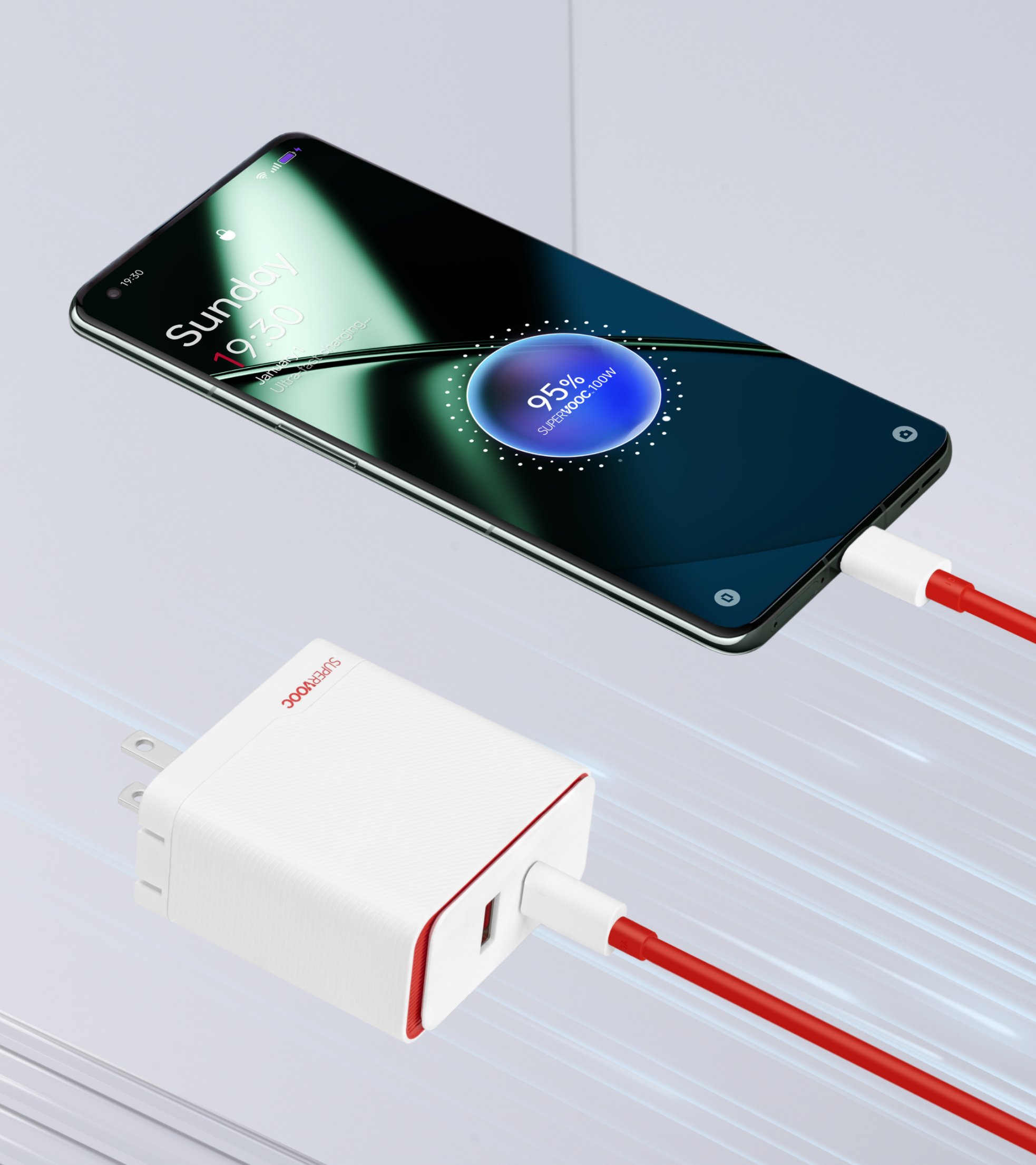

Flash charge with SUPERVOOC 100W

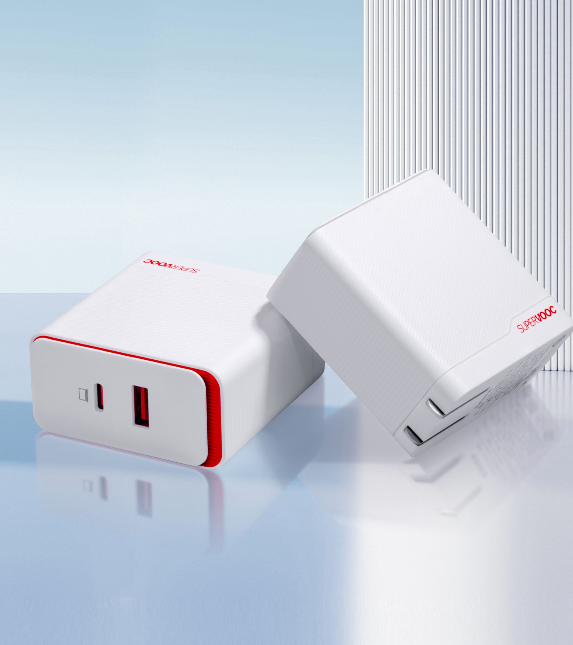

With USB-A and Type-C dual ports, the output of one single port is up to 100W . OnePlus 11 with 5000mAh battery capacity can be charged to 100% in about 27 minutes.
Fast charge with dual ports working simultaneously
You can charge your laptop and mobile phone at the same time to maximize productivity.
Innovative circuit design
The adapter's circuit integrates two transformers to improve power conversion efficiency.
One adapter to charge different devices
The adapter support SUPERVOOC, VOOC, PD, QC, PPS. It can charge not only mobile phone, but also smart terminals including laptop, tablet, smartwatch, bluetooth headset, and Switch consoles.
SUPERVOOC:100W Max // QC:30W Max // PD:65W Max // pps:63W Max
Folding pins for easy carry
The adapter with folding pins can save space for easy storage. It is an ideal partner no matter you are traveling or on business.
